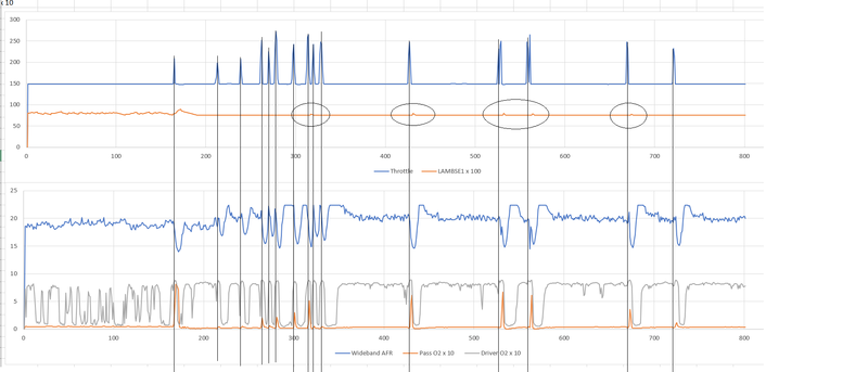

Unread postby pancakeshake » Sun Feb 03, 2019 2:55 pm
Step by step, piece by piece, getting there!
I got my IAC valve wired in and its working. It surges the idle a bit, but I assume thats to be expected with a base tune.
The video below shows the idle at a warm engine temp. The "wideband AFR" and "wideband Lambda" are actual readings coming from the MTX wideband gauge I have installed in my car. The LAMBSE gauges are direct from the ECM.
Few questions:
- Which HEGO is the correct one to be looking at? I assume HEGO2 as it is the one jumping above and below 0.4v
- After a rev the engine, my LAMBSE1 goes to 0.750 and stays there for exactly 1 minute. (video time 1:11-2:11 and 2:42-3:42). I'm just curious why it does that. What parameter sets that 60 seconds? Should I change it?
https://www.youtube.com/watch?v=3PleL00 ... e=youtu.be
Next up is this graph I made using paused data points from the data log. I did a few data points at each step where I held the throttle at roughly 1,000 rpm increases. It looks like the actual LABMBSE and the lambda read by my physical gauge are at least linear to one another. This means I just need to get my MAF curve and injector slopes dialed in correct?
https://photos.google.com/search/_tra_/ ... Myc-caZD3C

Unread postby decipha » Sun Feb 03, 2019 3:39 pm
surging idle is usually due to fuel not dialed in
u have to look at both hegos as they are each bank
if it goes to .75 lambda then the hego is reporting lean and the ecu is adding fuel to get it to switch, nothing u can adjust for u need to dial in your fuel or fix your hego issues
yep need to dial in your fuel

Unread postby pancakeshake » Fri Feb 22, 2019 8:56 pm
Im trying to make sense of my O2 sensor readings.
NOTE: All of this is done at a warm idle. Wide band consistently reads very lean (18-20 AFR)
I thought maybe my HEGO1 was bad as it was not reacting much. It was just reporting lean all the time while my other O2 sensor was bouncing all around. I bought a new O2 sensor to allow me to start with a clean slate and tried every variation of new / old sensors and determined that all the sensors are doing the same thing (working).
The HEGO1 (passenger side) located right next to the turbo flange, has little to no reaction during idle. It does however "blip" and react to a quick tap of the throttle. It goes between 0 and 0.8 volts for a quick second then drops back down to low voltage reading. If the throttle is held it just quickly reacts and goes back to reading very lean and stays there.
HEGO2 (drivers side) bounces around between 0 and 0.8v with a perfect trendline on 0.4v. This is during the initial startup where LAMBSE1 and LAMBSE2 are equal to one another. You can see that after a few throttle taps is starts reporting high (0.8v) all the time.
The picture shown is trying to show that both O2 sensors are pretty opposite of one another but when the throttle is tapped, the two sensors start to agree and converge on 0.4v and the reported AFR from my wideband drops to match (15 AFR). Once that split second passes, the O2 sensors go back to where they were and stay there.
I thought I read somewhere that LAMBSE1 was a good indication for being in closed loop or not. You can see that it is STUCK at 0.750 (open loop?) until I blip the throttle. Once I tap the throttle LAMBSE1 jumps for a second (indicating closed loop?) and the O2 sensors agree with one another, and my AFR drops.
What the heck is going on. Before I take the car on the road I just want my O2 sensors to agree with one another if and when im on closed loop.
Any and all tips are welcome as I am clueless at this point.

Unread postby decipha » Fri Feb 22, 2019 11:19 pm
are your o2 a enslrs swapped?
does one hego go lean and the other go rich axxoeding to what the other lambse is commanding?
if u have a sibgle turbo then hego2 needs to be disabled
read the pre tune info and hego write ups

Unread postby pancakeshake » Sat Feb 23, 2019 7:02 pm
decipha wrote:are your o2 a enslrs swapped?
What the heck is that haha?
decipha wrote:if u have a sibgle turbo then hego2 needs to be disabled
I went and disabled HEGO2.
After that I didn't see much change, but my fuel isn't all that close anyway so I didn't expect to.
Considering I was still crazy lean, I tried changing values in my MAF curve (FN036) to see what affect it had on the AFR. I didn't see any change while making small or drastic changes.
I moved onto my high /low slopes for my injectors. My scaled value for 60# which was 34.75. I started dropping that number until I had my AFR right around 15. I ended up with a high slope of 24.
I was able to log my LAMBSE1 and compare it to my actual lambda value on my AFR gauge and see that they trend the same direction, but they are off by a percentage.

Unread postby decipha » Fri Mar 01, 2019 12:11 am
was perload high enough to command that .875? if lambse's were at 0.95 that would suggest you were around .80 perload
oddly enough that jives with your 20% lean
no doubt your wot mafv was higher than your cruising mafv so your cruising fuel dial in has nothing to do with wot
sounds like you need to go kick up the maf 20% at those mafv

Unread postby pancakeshake » Fri Mar 01, 2019 4:22 pm
decipha wrote:was perload high enough to command that .875?
Good call, duh. I checked the log and I the highest I hit was .85 on the first and .86 on the second. Both of these occurred at 2.3 MAFv.
decipha wrote:sounds like you need to go kick up the maf 20% at those mafv
"So I went out for a long-ish drive tonight. I stuck with the "closed loop method" mentioned above. I did a data log --- pulled over --- adjusted fuel --- repeat. I was able to watch, in real time, my fuel dramatically improve. From 1.0-2.5 MAFv I was seeing less than 5% fuel error after a few renditions of the method mentioned prior."
My fuel error from 1.0-2.5 MAFv is looking really good if I gradually climb the RPMs. My KAM dances right around 1.00 during a steady pull. They only go really lean when I stab it.

Re: Getting Started...
Unread postby decipha » Fri Mar 01, 2019 8:04 pm
usually going stupid lean on the stab is due to junk injectors, where did you get them from? how much did you pay for them? are you positive they are genuine siemens?
how long does it stay lean? its odd that you reach the same mafv at wot that you do while cruising
for the time being, go divide the manifold volume AIR_MAN_VOL by 4 to give it more pump shot, see if it helps and if need be go to the tseif table FN1321 and highlight the last 3 columns (180,210,240 degrees) and multiply it by 3
that should alleviate any transient issues and let you dial it on in

Unread postby pancakeshake » Fri Mar 01, 2019 10:51 pm
decipha wrote:usually going stupid lean on the stab is due to junk injectors, where did you get them from? how much did you pay for them? are you positive they are genuine siemens?
I got them from a dude over on Corral.net. I paid $300 for the set. He is a legit guy on the forum and seller.
decipha wrote:how long does it stay lean? its odd that you reach the same mafv at wot that you do while cruising
Hard to say. I only got up to about 3300 RPM before I lifted. I was seeing numbers too lean for me to feel comfortable. It was at 16 and increased to 17....but it did drop about 2 seconds before I lifted. It dropped down to around 12 before lifting. Sounds like I need to grow a pair and keep my foot in it for the pull.
decipha wrote:how stable is your mafv? are you sure you don't have any fuel pressure dropping?
It seems pretty solid. When holding my MAFv at a set voltage during my test pulls, it holds pretty well. +/- 0.02 volts as I hold it. I DO have the FPR vacuum port hooked up to my manifold as I typically run a turbo.
decipha wrote:for the time being, go divide the manifold volume AIR_MAN_VOL by 4 to give it more pump shot, see if it helps and if need be go to the tseif table FN1321 and highlight the last 3 columns (180,210,240 degrees) and multiply it by 3
Will do
Is open loop commanded by the TPS reading a certain value (high voltage)? Or is it more to due with the load reading (PERLOAD)?

Unread postby pancakeshake » Sat Mar 02, 2019 10:15 pm
decipha wrote:for $300 u got fakes
They were lightly used.
decipha wrote:the tp wot threshold scalar and the wot threshold function toss her in to open loop based on throttle
fn320a tosses her in to open loop based on perload
I have my FN320A table set at 0.88. Does this mean anything over 0.88 load forces open loop?
I have my TP WOT Breakpoint (THBP2) set at 600. Does this mean anything over 600 on the TPS forces open loop?
My WOT Threshold -vs- RPM (FN513) is set at...
16384 | 550
1500 | 550
1300 | 400
0 | 400
Does this force open loop at 400 TPS @ 1300 RPM and 550 @ 1500 RPM?
I did some more driving today and things looks pretty good. I was able to really get on it and get into open loop by getting above 0.9 PERLOAD. However, I was only able to get into open loop that way. The methods mentioned above didn't seem to do anything (IF im understanding the functions correctly). Above 0.9 PERLOAD, LAMBSE dropped to 0.875 and the LAMBDA values seemed to match well.
Is it possible for the KAMs to be messing with my math as they are correcting my corrections? Is there a way to clean the KAMs and start with a clean slate? Is it worth doing?

Unread postby pancakeshake » Sun Mar 03, 2019 11:59 pm
decipha wrote:FN320A - Use to set the minimum load% required to permit entry into open loop operation according to ECT.
I have this set to 0.88 @ 242 and below. 244 and above is 0. Does this mean anytime I hit 0.88 PERLOAD I command open loop?
If yes, when it jumps into open loop where does it get the commanded LAMBSE value from? I cant imagine its the base fuel table, as 0.88 on the table is still commanding 1.00 LAMBSE.
decipha wrote:correct fn513 says (forces OL) in the title
16384 | 550
1500 | 550
1300 | 400
0 | 400
My TP is 150 at idle, with my foot off the gas. I verified my TP values sweep up to almost 1000 with my foot all the way down. Im not a lead foot, so Im usually pretty hesitant on my pedal even when going "WOT" hahaha.
This table is saying anytime my pedal gets to 550 @1300 RPM (400+150 = 550 TP REL, correct?) I should jump into open loop, correct?
Again, this is stating that ANYTIME my TPS sees 750 (600+150 for the relative TP) I hop into open loop(?)
For both of these TP REL scenarios, where does the LAMBSE get pulled from when in open loop? Similar to what I mentioned above, I cant imagine it is the base fuel table.

Unread postby decipha » Mon Mar 04, 2019 5:04 am
youfn513 the wot threshold doesn't use TP it uses TPREL so at closed throttle TPREL should be 0
1000-150 == 850 TPREL at WOT
lambse gets pulled from perload, so whatever perload your at it gets yanked from the base fuel table, everything is interpolated
